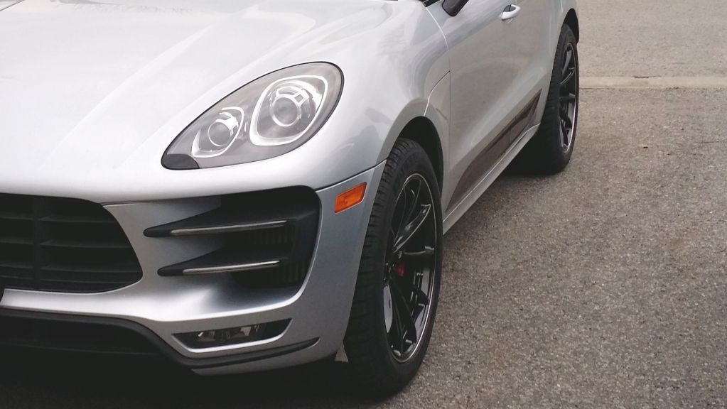

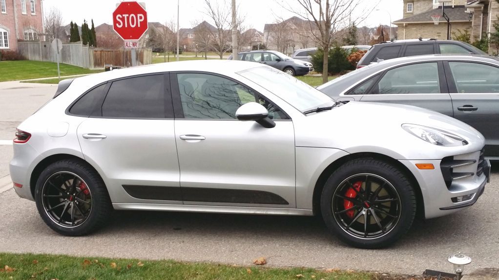

#335 ·
Get Porsche approved N0 tires. Michelin is preferred and probably the best.
Don't skimp on tires for a performance car like the Macan.

#341 ·

#345 ·
What are the offsets they are telling you for the different sized wheels? Most people like a "concave" look to the rims because it makes them look wider, but it is a purely aesthetic choice. I'm not sure it would be a deal breaker for me. Not having the bolt pattern in a 10" wheel is, however, very odd when they have it in other width wheels of that diameter. That probably would be deal breaker for me. This is why: most of the time with a spacer 15mm (a little less than 5/8") and below you would get longer lug bolts that would go through the spacer and into the hub. However, if you are having to change bolt pattern pacing then that means that you will have a custom spacer bolted to the hub with the normal pattern and then lug bolts from the wheel into the spacer. However, the lug bolt into the spacer will only have a max of 15mm of thread engagement because then they'll hit the hub. So they will have to give you special short lug bolts that will probably be a few mm shorter than 15mm because the last thing you want is to be torqueing down the lug bolts thinking that they are tight when in fact they are just hitting the hub and the wheel is actually loose.
Ok, so for offsets: the offset is zero when the face of the wheel that mounts on the hub is directly centered within the wheel. Offset refers to the displacement of that hub from the centerline of the wheel. A positive offset moves the wheel IN and a negative offset moves the wheel OUT. You will almost never see a negative offset, but FWD cars use higher offsets typically than RWD cars and AWD cars tend to be somewhere in the middle depending on what front/rear bias their particular system has. On the Macan the front wheels have 26mm of offset for a 9" wide wheel referred to as ET26. The rears have a 19mm offset (or ET19). So, when you go to the wheel calculator, put the stock wheel and tire specifications in the left column and your new wheel's specifications in the right column. If you are adding a spacer then you would just add the thickness of the spacer to the stock offset number. After you have everything entered you go to the very bottom of the page and it will tell you how much different you proposed setup will be - if the tire will be farther in or out than the stock setup.
So, the reason that most people like the "concave" look on a wheel is because you really can't get it with FWD cars because the wheel has to have a high offset which means that it will have a relatively flat face. Whereas RWD cars - use wheels with low offsets so that means that the wheel designer has more depth to work with in designing the wheel - wheel width helps this even more.
Some higher end wheel makers - and now even some mid-range wheel makers will mill to wheel to match whatever offset you need. That way you never have to use a spacer. That was a big reason I chose the company I did.
