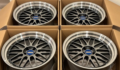

I've come across a few multi-piece wheels that are fitted for the F90 (2018-2023) M5. The specs are very similar to OE Macan specs:
21” HRE 305 Classic 3 piece wheels, 5x112, CB 66.6mm, (F) 21x10 ET23 (R) 21x11 ET29
BBS LM 20x10 +22, 20x11 +24 5x112
I have 10, 15 and 20mm spacers should there be any clearance issues, but given the bolt pattern, CB, and offsets similar to OE Macan, is there any reason these wouldn't work?
