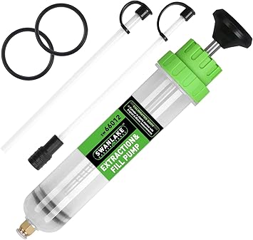

Belated thanks to ttmacan for the write-up and tech info. I just finished changing the TC fluid in our '15 Turbo at 28,000 miles. Got only a total of 480cc out of both the drain and the inspection fill ports. After installing the new drain plug, I could only put in about 300cc at the fill port before it started overflowing so I installed the new fill plug, removed the rubber vent plug and filled the remaining fluid down the breather tube. My MityVac wasn't strong enough for the job as a pump so I resorted to simply using a 20cc syringe with a 4 inch length of tubing. It was tedious but effective. Next time I'll find a larger syringe.
