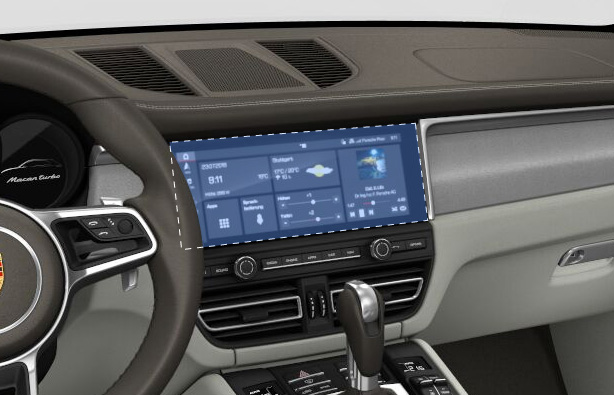

I think this option is better:
+ Built-in 4G LTE Sim card slot, DSP, Works DAB+, OBD2
