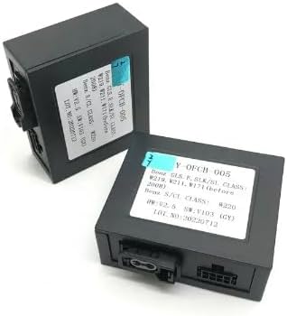

Do you have a link to that toslink to MOST adapter?
I can only find the version that does analog RCA to MOST.
Oddly, it seemingly has the same part number.
I’m providing all this information for anyone who would order, that they can negotiate the right box with the vendor.
The box in the last photo is also from Amazon, from a vendor called Plejbona. In the photo it looks like RCA to MOST, but is really Toslink to MOST.

Is the toslink to MOST adapter what is needed on the Macan's with the [9VL] Bose Surround Sound System or is that used with your aftermarket amplifier?

google and amazon search are failing me. i cannot find that MOST converter, even when searching by "Plejbona".
this is the most similar one i see listed but it has a different model number:
That’s the one… I don’t remember it being this expensive… I actually got it at $136.

No issues and thanks. For got to answer one question. Because Bose has MOST25 fiber optic, you need a device to convert either digital Toslink optical signal to MOST25 or an analog RCA signal converter to MOST25 in order to connect to Bose.
In my case, I was using MOST25 from PCM and then a decoder at the aftermarket amplifier from MOST25 to Toslink.
But for this unit you will need the converter to be able to use with Bose.

Makes sense. I'll see if they include the upgraded converter box in their next release. Look forward to your functional review video.

So, I decided to keep the DaiNav unit, as they are providing the optical output for me to install. Given that, I decided to stay with the unit, even with the red dot.
