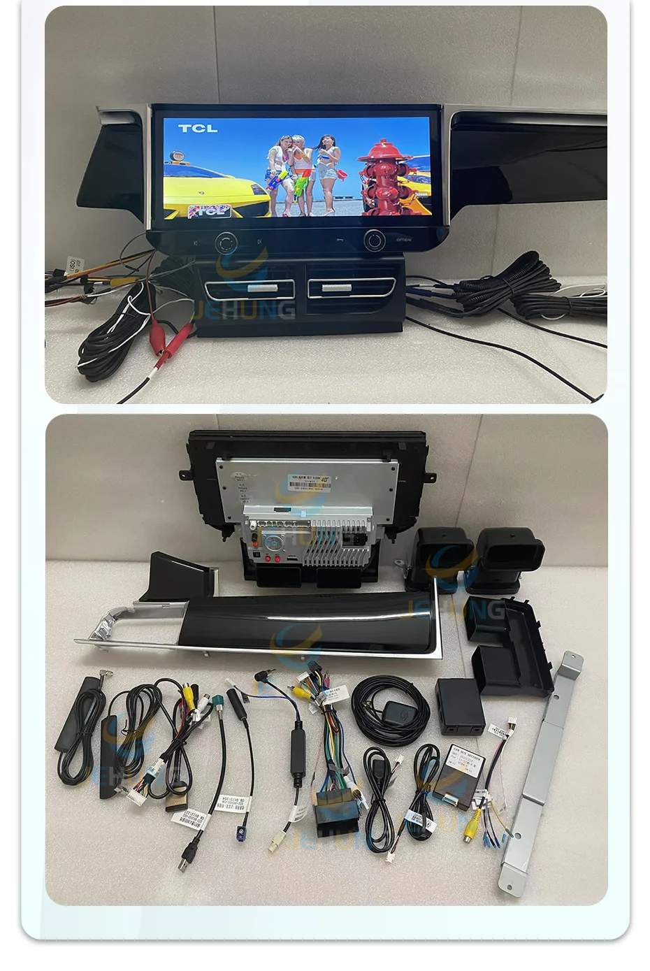

Finding one of these on aliexpress that I feel like I can trust has been a challenge. The one linked previously from the "Sadocom" store has an option for the MOST converter but is said to include the red dot which is a pass for me. Sorting by units sold, this one from the "JEHUNG Factory Store" comes up first:
Does anyone see any red flags here? Do we think this is an FYT unit or perhaps some other? The listing says it is Android 13 rather than 12.
I suppose I will have to buy my own MOST box unless anyone can make out one in this low quality picture. It appears perhaps that it has a toslink out in the lower left, which is what I need for a MOST output, correct?
I will message the seller to confirm it does not include the red dot and to provide more pictures of the front and back of the unit for the PCM 3.1 variant (model A). Any other questions I should ask?

This is a different unit. I don’t think is FYT but can’t say for sure. The settings menu looks different so I have to assume is different. There is one of my channel viewers that got this unit and we had been connected.
It is easier to install because of how the A/C ducts are designed. It has a different launcher. It seems you can actually program steering wheel controls, like the joker button (which can’t be done with the FYT unit natively unless you use a middleware like FytHWOnekey). My viewer said he was able to program joker button to skip songs in CarPlay natively in the settings. He also said that he needed to connect an external mic (provided).
Overall, it seems to work well. It seems to have a few advantages and disadvantages when compared to our FYT unit.

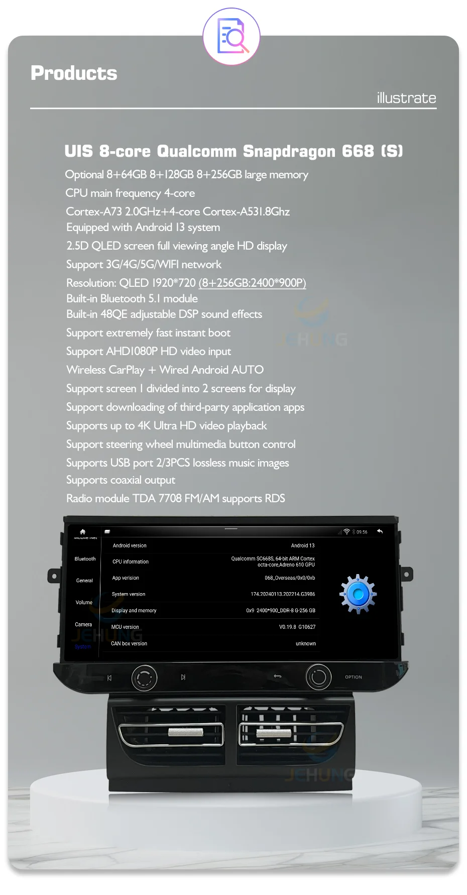

It looks like a newer version of our unit. Screenshot from an Aliexpress review.
Different resolution screen and processor.
Our unit in contrast:
This thread does make reference to newer FYT units using the Qualcomm Snapdragon processor which is what the you linked to appears to be. Doing a little more research it may be a Qualcomm Clone processor -- the description from here seems to indicate it is "Exceptional system performance based on Qualcomm 64-bit octa-core ARM Kryo 260 processors"
It sounds to me like it's a clone, but does it matter? Not really, I don't think it matters for what you/we are using these for. Just an information tidbit since I couldn't find any official Qualcomm SC668S processor specs.
