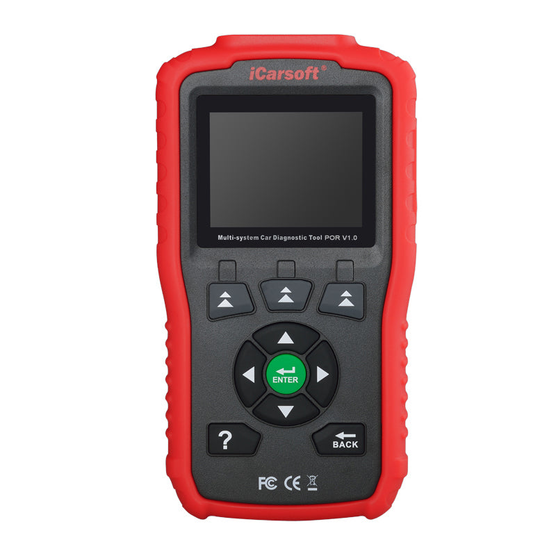

Sorry if I missed a thread about this device, but I would like to let you know what I have been able to do with it so far.
I recently did my own Brakes, and oil change and was able to reset the service "light" for the oil change.
Besides the OBD scanning the menu has the cabability to do the following.
Oil lamp reset It asks you for a date when you go to reset I imagine the ECU automatically does a year from the date you enter.
Brake Reset ( the first option in the brake reset gave me an error but I was able to move the parking brake to the install position using the second option)
ETCS Reset ( I don't know what this is so I didnt touch it) I think it resets the PDK calibration or whatever
Steering Angle reset ( same as above).
DPF reset. (don't know what this does).
I purchased the device off of Amazon for $150.00 , but it's available in many places. Make sure that you download the latest software onto the card ( it's a microSD card.).
I recently started another company so I don't have a lot of time to go through everything, but I wanted to report back that it did work for the Oil change reset, and the brakes.

#119 ·
arnieosp, Have you used this unit yet, and if so, does it do what it was advertised to do? I ask this because I purchased an iCarsoft POR V2 unit last spring intending to use it to register a new battery in my 2015 Macan S, something it was advertised to do. When I got it set up, it was unable to do so. Their tech rep finally admitted that it would not, but that they "were working on it". They had no set date when this advertised feature would actually be realized. I returned it. Sorry, but I have no use for something sold with "vapor ware".
#121 ·
I've used it before on the 987 and 981. I haven't tried on the Macan yet. We do offer them and also have the V1.0's in-stock as well if you're looking for a lighter version.

#141 ·
A late follow up. It does not seem that you can. The iCarsoft is a much more simplistic tool. 1 ON and 0 OFF logic. It does not possess the level of intelligence to register a battery. Now I can say you can run diagnostics on the battery by looking at voltage. But I saw no option to register a battery. You'll need one of the PWIS thingies... If I decide to keep this Macan, I might drop the coin, but not at this time.
#142 ·
There's a used Autel MS906 for sale on Ebay for $799 that we know will do the job. But that's still more than most of us can make sense of:
#143 ·
I might be wrong. This is a cut&paste from a thread:
"I have an update. I emailed both Autel and iCarsoft customer service. I asked about the 2019 / 2020, but assume the answers would be similar for earlier years as well.
Autel: The Autel MD808 Pro (available here for $233) does support Battery Management System, and allows you to register the new battery on a Macan. This is per Andrew Libert @ Autel
iCarsoft: The older iCarsoft Por II does not support BMS. However, the iCarSoft V2.0 (available for $146 here) does allow you to register the new battery on a Macan. This is per Barnett Davies @ iCarSoft.
So, it sounds like there are at least 2 reasonably-priced tools which allow you to reset the battery on a Macan for DIY people (like me). :) If anyone on this forum ever does it successfully (or tries it unsuccessfully), please add to this thread!"
Sorry bout that. Guess it does...
#144 ·
IIRC we eventually found out neither of these actually work on a Macan.
Reactions: Mleibrock
