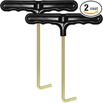

#95 ·
After struggling to remove the air vents on my 2016 Macan, I read I should be using a hook to reach in and grab the back of the vent so as to not damage it. There are some DIY instructions to build one and I have seen a few for sale for $20-$60. Then I found some hooks made to install trampoline springs that worked of me and only cost $5.99 for two!
Not an affiliate, I don't earn anything if you buy from the link...just a hopefully helpful suggestion. I'd offer to sell one, but would be cheaper to buy two from Amazon with free shipping.
