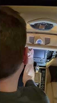

The hook goes on top corner. I marked my hook so I know when is properly hooked. Use that measurement to mark yours.
Then, I found it best once you have the hook in place, to pull with one hand and put the other on top of the trim. This will provide you with a controlled movement when it actually pops out.
Use some grease on those pins afterwards… it worked for @Teddis.
