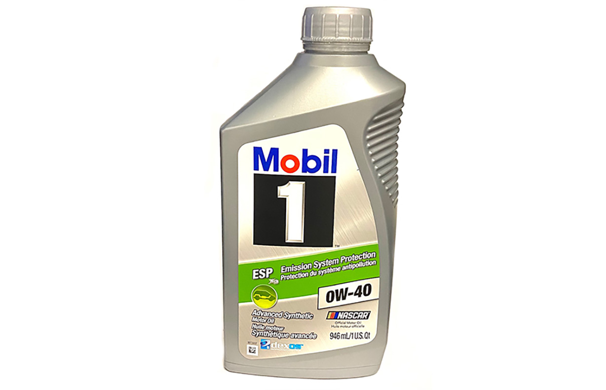

Here is the new oil:
  • Helpful

Mobil1 Cxx spec 0/30 and 0/40 oils are their ESP version, like pictured above. They're a group IV true synthetic oil. The more common Axx spec 0/30 and 0/40 is their AFE version, which is a group III, which is called 'full synthetic' in the US, but it's not, due to having a dino oil base stock. But changed every 5K miles or every year wouldn't make a difference IMO. But if you want to run it longer, then I'd definitely use the ESP. I put the ESP 0/30 on the 2018 Macan, but mainly to be able to leave it 2 years, since it only sees like 6K miles tops in 2 years. Porsche approved it for 2 years, but I think they went back to 1 year, probably due to dealers complaining they were losing service business. My local dealer wanted $400, so I sent it to **** this time. Last year they charged me over a grand for an oil change and cabin filter change. Aholes. Ha ha. Bought the oil at Walmart for around $50, the filter thru Suncoast, and did it myself. Dealer didn't even drain it properly, and made a mess when they sucked it. Was scared when I saw the huge stain under the belly pan, but fortunately, no leaks; it was from above. Never again to a dealer if I can avoid it.
