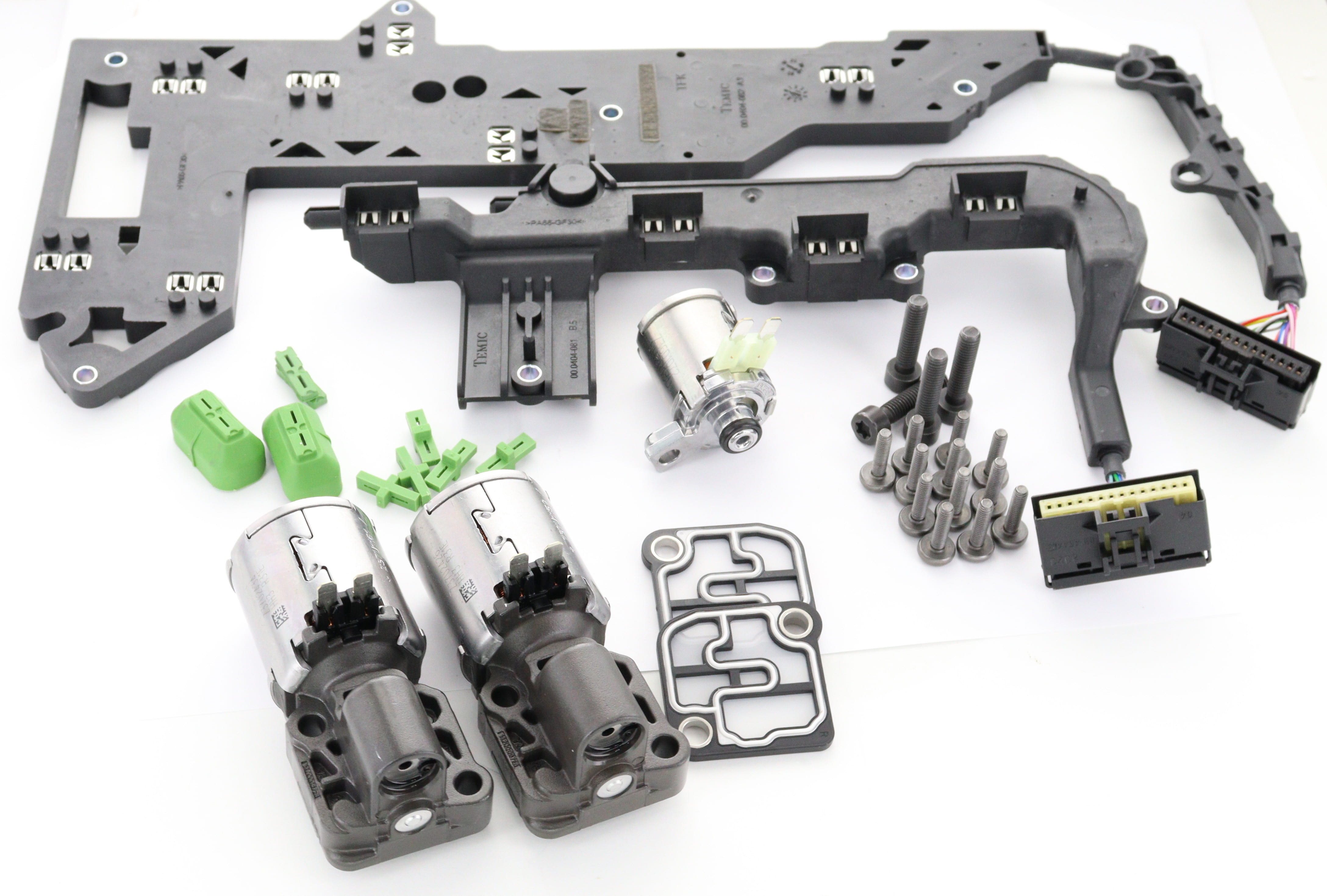

You could try pulling the Mechatronics out and just replacing the two "Circuit Boards", cheapest thing to try.
Audi B8/B8.5 S4 Quattro 3.0T Drivetrain DSG Transmission - 0B5398009F - Mechatronics Repair Kit 0B5398009F (0B5 398 009 F) (ecstuning.com)
Another forum member had issues only when the transmission warmed-up. It was fixed with new "circuit boards", which also contain the temperature sensor for the clutch fluid, and an RPM sensor.
There are many of these circuit board repair kits available on Ebay and Amazon. Some are much cheaper than the "real" VW/Audi kit, but they may work fine....
The next more expensive fix is to get a new or rebuilt Mechatronics unit (just the valve body part, not with a new TCU), and install the original TCU onto the new valve body. Then, no TCU programming is needed (to write the VIN into it (needed for the immobilizer).
But, you will need to run the full Mechatronics adaptations/calibration with your PIWIS.
Valve body (mechatronics) without electronic control unit, automatic transmission 0B5 (DL501) 0B5325025T 0B5325031N regenerated (maktrans.net) "
So, cheap & easy, right? @VAGfan, you have my attention.
Hopefully, @VAGfan will visit us to lay some DIY knowledge on us. If not, you're stuck with me through this journey.
So, first step, let's figure out what parts I'm gonna need. @VAGfan gives us a link to the ECS Tuning "Mechatronics Repair Kit", which carries a $610 price tag (ouch). He also says there are circuit board repair kits on eBay and Amazon for much cheaper. So, I'm going to check those out (and will report back). Plus, as long as I've got the Mechatronics unit out of the tranny, it sounds like there's some sort of filter - might as well replace that. And of course, new PDK fluid. So, off to eBay and Amazon I go.

Pulling the Mechatronics units out to install the Chinese rebuild kit from Amazon ($228.54) with new boards and 3 solenoids (N436, N440 & N472).

I replaced the Sheng Hai reman Mech unit with my original Mech unit that was "rebuilt" using the Amazon Chinese kit (2 PCB boards, N436, N440 & N472 solenoids).

I ordered what were listed as brand new OEM VAG solenoids N436, N440, N471 and N472 from Maktrans in Poland to install on my original Mech unit (not the Sheng Hai reman) to replace the Amazon Chinese rebuilt kit solenoids (N436, N440 & N472). I did this because even though the Audi forums say the N472 solenoid is the likely culprit for P17D4, I am concerned that once the fluid warms up, that another problem will surface with one of the other solenoids. It was throwing P17D7 codes after just the separator plate was replaced (after Repair 1, before the Chinese rebuild kit was used). Sheng Hai’s troubleshooting guides says that the 2 PCB boards and 3 solenoids (N436, N440 & N472) rebuild kit will fix P17D7. So the Chinese kit may have fixed P17D7 but a faulty Chinese N472 may have caused P17D4. I should probably have also ordered new OEM PCB 1 & 2, N433, 434, 435, 437, 438 & 439 solenoids just to be sure. But, Maktrans PCB 1 & 2 ($104 for the pair) look to be made in China anyway (and I already have new Chinese PCB 1 & 2 installed in my old Mech unit). Maktrans does sell N433, 434, 437, 438 (new VAG $81 each) and N435 & 439 (new VAG $66 each) solenoids. But, since all of the OEM Audi kits consist of N436, N440 & N472 & PCB 1 & 2, I was betting that’s where my problem lies. So, once installed in my original Mech unit, I’ll have new Chinese PCB 1 & 2 and new OEM VAG N436, 440, 471 & 472 solenoids. The conventional wisdom is that it’s the solenoids, not the boards that are the bulk of the problem, so that's another reason I decided not to replace the Chinese PCB 1 & 2 with OEM boards.
Received the Maktrans solenoids N436, N440, N471 & N472 on 10/18/24 (ordered 9/30/24). They were not new units, despite Maktrans’ website listing them as new (they were wrapped up together in plastic wrap and were covered in oil).
Installed the Maktrans solenoids last night. Went through calibration steps 1 & 2 fine, but failed to complete step 3 (just like after the 5th repair). It would give me a momentary “Basic setting routine has ended correctly”, but then continue to run the routine and ultimately give me an error message.

The question now is whether to order new OEM PCB 1 & 2, N433, 434, 435, 437, 438 & 439 solenoids. Or, based on the current codes and clutch values, is it likely that it really does need a new clutch pack.
#121 ·
Buy the parts from the link I sent you - all new Audi plates and all six solenoids bottom area are 750 usd delivered in 2 days. Which is price of only plates feom fcpeuro. No affiliation with the vendor - am a happy customer. Why aren’t you fighting with maktran for sending you used stuff.
