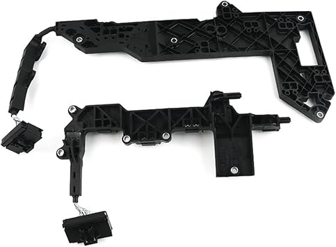

So, yesterday I got the dreaded "Fault Of The Engine Control Unit. Gearbox fault possible. No R-gear. Possible to drive on" warning on my 2018 Macan GTS that I just bought. It drives fine until it warms up, then it starts jerking, then begins skipping gear 4, then skipping gear 2 and 6, and finally the above light comes on and reverse doesn't work. There is a thread in here on this and other transmission problems: https://www.macanforum.com/threads/...possible-no-r-gear-drive-on-possible.115490/page-11?nested_view=1&sortby=oldest
But, I'd like to create a dedicated DIY for this problem as that thread is now 8 years old and over 500 posts. So, it takes a minute to read through it to glean the info to either do the repair yourself or point your indie in the right direction. From that thread, what you are going to experience if you roll your Macan into the dealer is a recommended $25,000 tranny replacement. If you roll into your typical indie repair shop, they're going to likely recommend a $5,000 new Mechatronic valve body, or some version of used or rebuilt Mechatronic in which the part cost is about $1,500, plus labor.
However, our resident tech expert, @VAGfan , describes in post #482 of the other thread a DIY repair that sounds relatively easy (especially if you have access to a lift) and inexpensive:
"The first troubleshooting step is to get the stored trouble-codes (DTCs) from the Transmission Control Computer (aka "TCU" or "Tiptronic Transmission Control Module"). PWIS and other Porsche capable scan-tools often list the TCU as a "Tiptronic", even though it is really a Dual-Clutch/DSG/PDK/S-Tronic transmission. The "Tiptronic" name is what Audi calls a conventional torque converter automatic transmission with electronic control and manual shifting features, and the scan-tools just used the wrong marketing name for it.
You could try pulling the Mechatronics out and just replacing the two "Circuit Boards", cheapest thing to try.
Audi B8/B8.5 S4 Quattro 3.0T Drivetrain DSG Transmission - 0B5398009F - Mechatronics Repair Kit 0B5398009F (0B5 398 009 F) (ecstuning.com)
Another forum member had issues only when the transmission warmed-up. It was fixed with new "circuit boards", which also contain the temperature sensor for the clutch fluid, and an RPM sensor.
There are many of these circuit board repair kits available on Ebay and Amazon. Some are much cheaper than the "real" VW/Audi kit, but they may work fine....
The next more expensive fix is to get a new or rebuilt Mechatronics unit (just the valve body part, not with a new TCU), and install the original TCU onto the new valve body. Then, no TCU programming is needed (to write the VIN into it (needed for the immobilizer).
But, you will need to run the full Mechatronics adaptations/calibration with your PIWIS.
Valve body (mechatronics) without electronic control unit, automatic transmission 0B5 (DL501) 0B5325025T 0B5325031N regenerated (maktrans.net) "
So, cheap & easy, right? @VAGfan, you have my attention.
Hopefully, @VAGfan will visit us to lay some DIY knowledge on us. If not, you're stuck with me through this journey.
So, first step, let's figure out what parts I'm gonna need. @VAGfan gives us a link to the ECS Tuning "Mechatronics Repair Kit", which carries a $610 price tag (ouch). He also says there are circuit board repair kits on eBay and Amazon for much cheaper. So, I'm going to check those out (and will report back). Plus, as long as I've got the Mechatronics unit out of the tranny, it sounds like there's some sort of filter - might as well replace that. And of course, new PDK fluid. So, off to eBay and Amazon I go.
#3 · (Edited)
I'm going to try to fix this by just replacing the two circuit boards first (hoping the Mechatronics unit doesn't need additional repairs). Those are available in a kit from Amazon that costs $109 and will be delivered tomorrow:
The ad lists these as "refurbished". Plus, under the description, it's sold by "TrollingMAN auto parts" and says "Premium Quality, Cheap and Cheerful, Easy to Install with related installation video". Well, if it's cheerful and sold by a trolling man, I'm sold.
Next, I'll go watch @Santirx 's excellent DIY video on changing the transmission fluid, spin-on filter and internal suction filter:
Looks like I'll also need to order:
  • 6 1/2 liters of Motul Multi DCTF Dual Clutch transmission fluid ($14.02 per liter on Amazon when you buy a 12-pack, plus a single to get 2 services)($101)
  • Transmission service kit ($96.67 on eBay) that includes a pan gasket, external spin-on filter, internal suction filter, 2 O-rings, a crush washer and 15 pan screws (FCP Euro has this for about the same price per Santirx 's video)
  • Crossmember bolts (torque to yield): Two each PAF 005 372 ($4.20 each) and four each PAF 911 511 ($6.58 each) for total with shipping of $38.28 at www.gaudinporscheparts.com
So, total cost of parts, including everything listed above is $345, including taxes and shipping.
All of the parts should arrive this week, and I'll post again once it all arrives.

I spent several hours last night removing the Mechatronic valve body, replacing the separator plate and then putting it all back together again. I purposely did not install the new circuit boards that I bought because I wanted to test the theory that the problem was the missing pieces of paper gasket material on the separator plate that everyone seems to have. The first thing I did was to check the Transmission Control Unit to see if I had fluid in there like @tallkyle had. Mine was clean and dry inside.
Next step was to separate the two halves of the base of the Mechatronic unit. 35 screws there, in case you are wondering, so best to have an electric screwdriver or ratchet. 5 of those screws are about half an inch longer than the others, by the way, so be sure to note where the longer ones go (they are clustered around the top left).
When I separated the halves to expose the separator plate and gasket material, sure enough, both sides of my separator plate were missing gasket material in the same place that everyone else has.
At that point, I was feeling pretty confident that I had found the problem and that my transmission would be functional again once I got it back together. Spoiler alert, it wasn't.
Once I got the Mechatronic back base screwed back together, installed back in the transmission, the transmission put back together and properly filled (using the warm-up and refill procedure monitoring the transmission fluid), I attempted to recalibrate the transmission. I recalibrated it last week thinking that might help before I had to tear it apart, and my Foxwell NT809BT bi-directional seemed to do the recalibration (I heard strange noises from underneath and it walked me through moving the gearshift from P to N and back). But, last night, my scan tool was only having me go through verifying that it was in Park when I had the gearshift knob in Park. So, I don't think it recalibrated.
I started the car back up after trying to recalibrate and put it into Reverse. There was a noticeable jerk when the car went into Reverse. It did engage Reverse, but only for a few seconds before throwing a transmission malfunction light telling me there is no Reverse. It was throwing a P17D700 code, Clutch 2 pressure too high. Reverse was non-existent. I managed to get it back into the garage and called it a night.
So, now, I'm wondering what to try next. I didn't use my new crossbrace bolts thinking that I might have to do take it all apart again. I could have replaced the plastic circuit boards, but I wanted to test the theory that the real problem is just the missing gasket material from the separator plate. So, I am ready to go back in - the question is what to change once I get in there? Should I try replacing the plastic circuit boards as that's a common problem? But, from reading the other threads, I'm not sure that is going to do anything. Do I need to replace my Transmission Control Unit, which includes the pressure sensors? Could it be as simple as borrowing a friend's scan tool to try to recalibrate the transmission?

Having read through multiple threads now, the cause could be one of 2 things:
1. One of many possible problems with the Mechatronics unit (circuit boards, solenoids, sensors, etc.). The only thing I fixed was missing gasket paper on the separator plate. I didn't do any other troubleshooting on the Mechatronics unit; or
2. My transmission control unit is bad. The reason I say this is because of @tallkyle 's thread. That seemed to be his problem. However, I didn't have any fluid inside the TCU like he had. Ultimately, he had his TCU cloned and the new TCU seemed to fix the problem. Please correct me if I misinterpreted that.
So, since there are multiple potential problems with the Mechatronics unit, my next step is going to be installing a rebuilt Mechatronics unit. @tallkyle was nice enough to offer to sell me the extra one he has, so if it is still available, I am going to take him up on that. If I replace the entire Mechatronics unit with a known good one, yet the problem persists, then the next step would be to have my TCU cloned and replace that. Stay tuned . . .
#27 ·
@AoxoMoxoA posted in a thread over on Rennlist a link to Sheng Hai's website where they list the malfunction codes and the most likely way to fix them. Sheng Hai is the company that I bought my separator plate from, but I didn't notice this page on their website when I visited it to buy the separator plate. So, thanks to @AoxoMoxoA as this is a handy reference to look up whatever fault code you may have to get an idea on how to fix it. Here is the link:
With the P17D7 code I have, it says to use the Mechatronic repair kit that they sell. So, installing a refurb Mechatronic unit seems to be the right way to go since it incorporates that repair kit.

FYI, there is a misunderstanding about the "circuit boards". They are not circuit boards, they are just plastic trapped wires that lead the connector pins over to the individual solenoids, with one exception, the speed sensor that is located on the top of the vertical board (the circle on the top). That sensor is a basic pulse generator (micro coil that detects a magnetic piece going by it). There is nothing delicate about them and they are often not the culprit.
Maktrans solenoids are tested but also rebuilt, specifically the parts that fails is the brass bushing at the end of the solenoid that wears out no longer keep oil pressurized.
#48 ·
Maktrans solenoids are tested but also rebuilt, specifically the parts that fails is the copper bushing at the end of the solenoid that wears out no longer keep oil pressurized.
This was my understanding about the circuit boards as well - thanks for clarifying. I’m about to stuff a bunch of maktrans solenoids into the mech so that makes me feel better lol. People seem to have fairly good results with their stuff.
