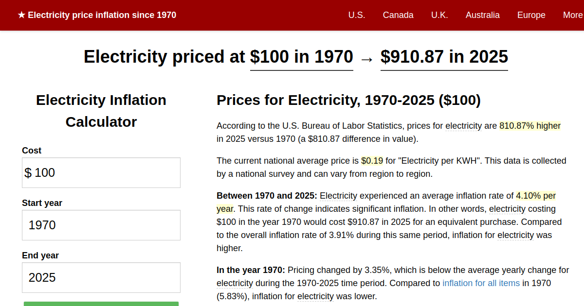

What is the average cost per KW in the US, over here in the UK it’s approximately 65-70p/KW which is roughly 3-4 times the price of charging at home which is why most people only get enough to get them back home to charge there.
It depends, by state, on how electricity is generated
65 pence ~85 cents. Thats crazy high. Avg about 16 cents, I see about 12 cents, That equals ~ 9 or 10 pence
But if you drive from Chicago to NYC you aint charging at home and thats not a long trip. Drive NYC to LA, truckers go long haul across the country all the time.
😱 You are only paying 9-10p/KW at a charging station, that is nuts. Surely that’s way cheaper than an equivalent sized ICE with similar performance, even with your much cheaper fuel prices. The only negative I can see will be charging times and possible waiting times to get a charging unit if busy.
Still can’t get my head around those prices. 🤪
