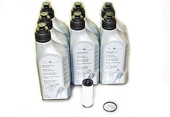

Ordered the parts needed to do this today. I was a bit shocked by the cost of the interior filter (some call it a "cooling filter") and the pan gasket, but found AutohausAZ.com has a Febi made filter for $21 and an Elring pan gasket for $15, so I decided to go ahead and replace the interior filter while I'm at it even though it's apparently not required.
AutohausAZ also has Fuch's version of the fluid on sale for $10.93 per quart, as well as a Febi made external filter for $13 (including the seal, unlike the OEM one).
Oddly, Autohaus does not carry the O-ring for the internal filter, so I had to order that elsewhere.
So I was able get all the parts for about $135 delivered, and that's with changing the internal filter which most people and dealers apparently don't bother with.
