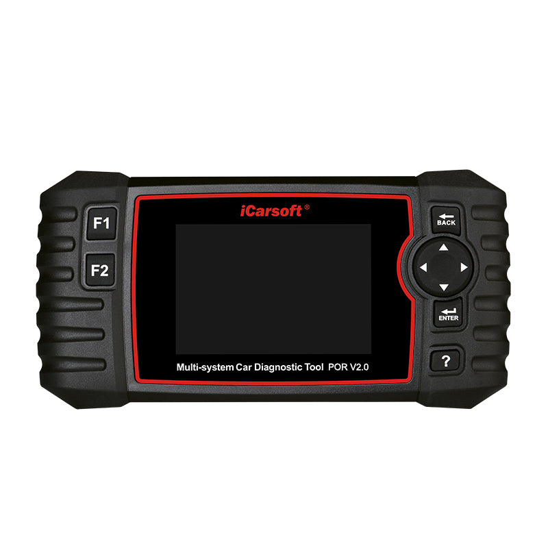

Ready to pull the trigger... Icarsoft V2.0. Supposed to do oil, service, e-brake, batt registration, that all I really need. Does it? If I'm making a mistake please inform me!
Just seems like for $145 It's the way to go, but could be persuaded otherwise. Thank You!

Before you put in the order, maybe double check with icarsoft for your exact model year Macan. I read inconsistent reports. Hopefully another owner will come in with first hand experience (like you I want to buy something, but would prefer to have some feedback first).

I bought the Icarsoft V2.0 18 months ago because it was supposed to do battery registration. After I got it, I discovered that it would do this for all Porsche models except the Macan. I contacted their tech support and they confirmed that it would not perform a battery registration on the Macan. They told me that although they were "working on it", they had no date in mind. I returned the unit and got a refund. Perhaps they have updated it. I don't know. Best to hear from someone on this forum who has actually performed/verified this action rather than speculating.

These were the posts I had seen on POR V2.0 regarding battery registration. Not sure if it works for all years of cars, or 2015 - 16 only. I'll be anxious to see what you hear back @red67.
