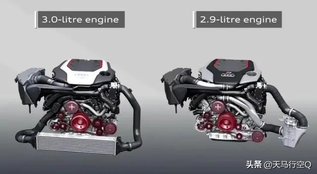

3.0T EA839 (95B.2) | 2.9T EA839 (9Y) | |
Macan Trims | '20+ GTS/Turbo, '22+ S | '19 - '21 S |
Bore x stroke | 84.5 x 89 (2995 CC) | 84.5 x 86 (2894 CC) |
Compression ratio | 11.2:1 | 10.5:1 |
Turbo layout | Single Twin-scroll Turbo | Twin Turbos |
Intercooler | Air-to-air | Water-to-air |
Boost pressure | 19 psi (2.3 Bar) | 22 psi (2.5 Bar) |
Stock output (APR measured) | 361 hp, 368 ft-lbs (Macan S) | 442 hp, 419 ft-lbs (Cayenne S) |
Tuned output (APR, 93 AKI) | 408 hp, 499 ft-lbs | 502 hp, 545 ft-lbs |
Torque a 2,000 rpm (stock) | 360 ft-lbs | 350 ft-lbs |
