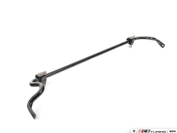

Back on a stiffer rear sway bar to reduce understeer . . .
227401
Looking at the rear sway bar where it attaches to the drop link:
It looks to me like there would be room to drill a 2nd mounting hole, shortening the lever arm to effectively increase stiffness by 10-15%. Has anyone tried this?

As an update, I was just watching Savage Geese's review of the 2019 Macan S, and he says in the video that they updated the sway bars with stiffer units to dial out some of the understeer, so I may look into swapping those in if they will fit.
I am also planning to try drilling a second set of mounting holes for the end links closer to the bend of the sway bar on the rear one in the mean time, so see how that effects things...
I'm wondering if the Macan sway bars are "the same" dimensionally compared to an Audi SQ5. Reason: there are aftermarket upgraded sway bars and links for the Audi. Just wondering if anyone has any first-hand knowledge if the stock parts are the same dimensions. If they are, theoretically, those parts could be used on the Macan.
They look very similar
